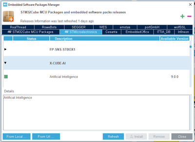

Once both install, we need to install the package X-Cube-AI in cubeMX:
  • Open cube MX
  • Click INSTALL/REMOVE on the right main screen
  • Then click on the STMicroelectronics tab and look for X-CUBE-AI
  • Select the last version (9.0.0) and click install

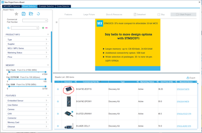

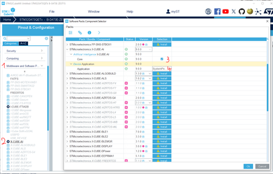

Then, we need to create a fake project, just to finish the install:
  • Go back to the main screen
  • Click ACCESS TO BOARD SELECTOR
  • Select a random board by double clicking on its image:
  • Click yes on the pop up
  • Then click on Middleware and software package -> X-Cube-AI -> check the core and select SystemPerfomance for the application
  • Click OK
You should have a download of EdgeAI starting. It is what we wanted to get.
