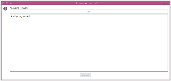

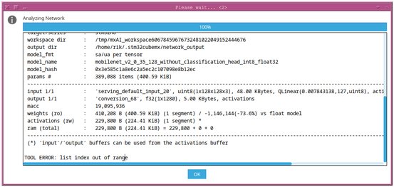

I am facing some strange errors when trying to analyze any TFLite model. The errors are occurring in the following situations:
Situation 1: STM32Cube.AI MCU Runtime
When analyzing a TFLite model, it fails and shows an error message: "TOOL ERROR: List index out of range."
Situation 2: STM32Cube.AI Neural-ART Runtime
After clicking on the Analyze button, it's stuck at 0%. Nothing else happens, even after I wait for 30 minutes.
I am using:
CubeIDE version: 1.17.0
X-CUBE-AI version: 9.0.0 and 9.1.0
Please note that all those TFLite models work fine with CubeIDE 1.16.0, X-CUBE-AI 9.0.0, and STM32H7A3.
I am attaching 2 tflite models for your reference.

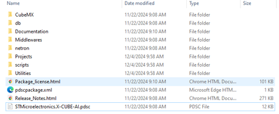

Hello @AM-adben ,
Could you please verify again your version of X-CUBE-AI ?
Neural-ART Runtime should only be available from X-CUBE-AI version 10.0.0.
Did you install the runtime through STM32CubeMX or STEdgeAI-Core installer ?
My first suggestion would be to uninstall X-CUBE-AI through STM32CubeMX, and install it again. After that, verify the content available in C:\Users\your_username\STM32Cube\Repository\Packs\STMicroelectronics\X-CUBE-AI\10.0.0.
You should have this file tree:

2025-01-24 3:06 AM
Sorry for the late reply as I was on leave.
I installed X-CUBE-AI version 10.0.0 which was not availabe in CubeMX earlier when I made this post. Anyway, now I can analyze the model using "STM32Cube.AI MCU Runtime" option. But, "STM32Cube.AI Neural-ART Runtime" requires STEdgeAI-NPU package which I don't have access to. I requested for this package earlier. Today I requested again. Without it, I can't use the NPU.
2025-01-24 5:10 AM
Hello @AM-adben
You are right, STEdgeAI-NPU package is required in order to use Neural-ART Runtime.
If the request was done more than 2 days ago, could you please check in your mailbox if this mail did not go in spam folder ?
Best regards,
Yanis
2025-01-24 10:32 AM
Thanks! The mail was indeed in spam.
I downloaded it and "analyze" using STM32Cube.AI Neural-ART Runtime worked fine. I am yet to run the model though.
Thank you for your assistance.
