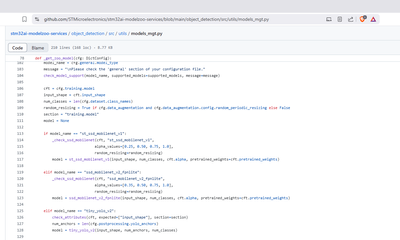

2. In the training Readme I read that I can train mobilenet with pretrained_weights = imagenet. But this cannot be done with any of the yolo. The option pretrained_weights is not recognized. However in the documentation it is mentioned that for the tiny_yolo the pretrained_weights are from COCO. So it there a way to use pretrained weights also for the yolo models?

Yes, only imagenet on SSD models can be used as pretrained weights at this time.

Only SSD model have the option to be used with the pretrained_weights option and it is available with imagenet only.
For all other model, you can import the .h5 model using model_path (at the beginning, in general) and retrain the model, only with the same number of classes. Most of them are trained with either COCO person (1 class) or COCO 80 classes I believe.
For yolov8, we provide only COCO person, but on ultralytics, where the original models are, you can find them trained on COCO 80 classes.
As Laurent also said:  Full transfer learning is not available yet for Object Dectection, we are working on it.

Regarding the pretraining of the tiny yolov2 I tried to use the option but it fails with "unrecognized option" message. As I see in the source code, the pretrained_weights are not expected.
