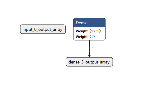

When I import this into X-CUBE-AI in STMCubeMX and analyze it, there are no Errors. However when I press show Graph, you can see that it imported just a single layer, even though there should be 4.

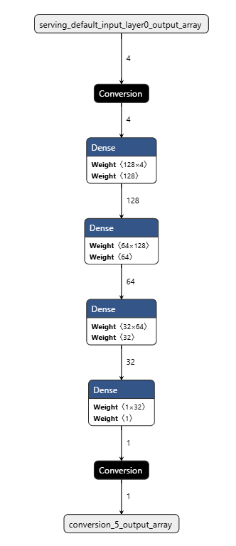

When i upload the same model in ST Edge AI Developer Cloud, it does the layers correct:
I can even run the benchmark in the cloud on the same STM32H7 which I have physically on my desk and it works.
Because the layers are not detected correctly in my local STM32CubeMX, i get really bad performance when I validate the model. I also tried importing .h5 file, but it doesn't change. Is there some limitations in layers or do I need a special export of the model?

Hello @wga,
We had a bug regarding sequential model in tensorflow. It was fix in stedgeai core 2.2 (X Cube AI 10.2.0).
I think that in the dev cloud, it was using the newest version, but I think that in local with cubeMX you may be using an older version.
Could you please install the last version of X Cube AI (10.2.0) and tell me if it solved your issue.

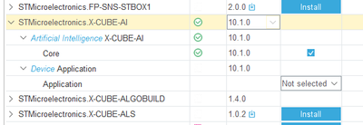

thanks for the answer. It seems that 10.2.0 didn't get fully distributed. My CubeMX and STMCubeIDE doesnt detect any available updates for the component.
On Developer Cloud i can select ST Edge AI Core 2.1.0 and it works as well. Is it possible to manually install 10.2.0? Would you recommend that?
Hello @wga,
Yes, the 10.2.0 is out, for some reason, it does not show in cubeMX, but the version is stable.
You can download it from manual files:
To download the latest files:
X-CUBE-AI - AI expansion pack for STM32CubeMX - STMicroelectronics
Unzip the .pack file and select it in cubeMX while installing.
Let me know if it solves your issue.
Have a good day,
Julian

Hi Julian,
with Version 10.2.0 it is working. Thanks for the support :thumbs_up:
