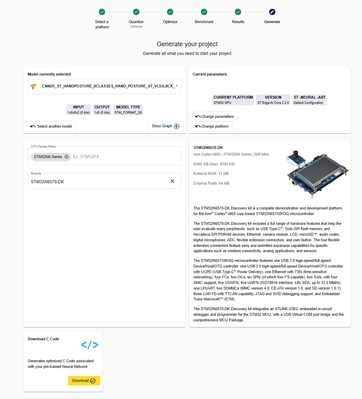

I have recently bought a STM32N6570-DK and I am trying to implement an example model from the Model Zoo on my board. I am able to get results and benchmark but when I go to Generate Your Project I am only able to Download C Code as seen in the image.
How do I now use these files in the zip? In this tutorial, it says that "The .zip package contains all network .c and .h files, the Cube.AI runtime library files, and the stm32ai command line reports and output. Users can replace the existing files in their project with these newly generated files", however when creating a new project, I do not have these files.
Are there any guides on how to integrate these files into a new project for the STM32N6570-DK? Any help will be much appreciated.
Thanks!

The Dev Cloud main purpose is to benchmark a model.
To then create an application, I would suggest to look at the model zoo services.
In your case, you seem to be interested in the hand posture use case.
Please find useful links below.
Note that with the model zoo services, you can also retrain, evaluate and quantize models if that is something that interest you.
Deployment guide model zoo:
stm32ai-modelzoo-services/hand_posture/docs/README_DEPLOYMENT.md at main · STMicroelectronics/stm32ai-modelzoo-services · GitHub

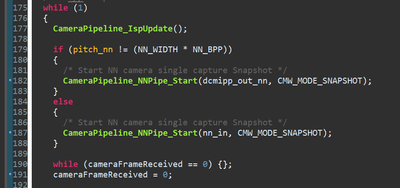

I’m trying to step through the code, but I’m running into some strange behavior. When I debug and use the Step Over button, the step controls grey out (see image) as if the code is running, even though there are breakpoints set further down. At that point, execution also seems to pause on the board.
When I use breakpoints together with the Play button, I see other odd behavior—for example, execution will jump from inside the if block directly into the else block (see image).
For context, this is with the object detection use case.
Can you explain why this is occurring? Perhaps due to deletion of

The dev team says that the workaround should not create such behavior. We will test on our side.

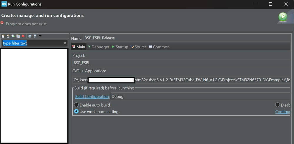

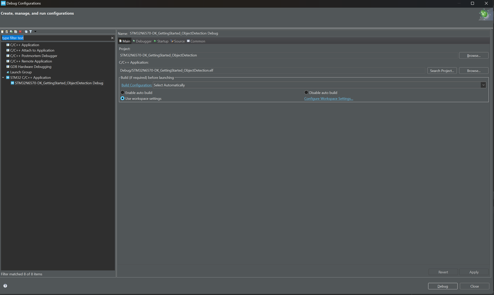

I am adding images of the debug config for more context. I initially had a problem with the debug config as seen below. Note that it built with no errors.
I added the elf file manually and now this is how it looks.
 Now I can debug and run, but I get very strange behavior with debugger.
