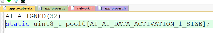

..\..\AI\X-CUBE-AI\App\app_x-cube-ai.c(93):error: #20: identifier "AI_AI_DATA_ACTIVATION_1_SIZE" is undefined
static uint8_t poo10[AI_AI_DATA_ACTIVATION_1_SIZE];
...\...\AI\X-CUBE-AI\App\app_x-cube-ai.c(95): error: #28: expression must have a constant value
ai_handle data_activations0[ ] = {poo10};

fauvarque.daniel
The correct constant is probably AI_DATA_ACTIVATION_1_SIZE
I don't know why you have twice AI_
but I don't know how to fix this issue
fauvarque.daniel
Correction, you probably named your network AI that's why the constant is like that
it is defined in the network_data_params.h file (or ai_data_params.h probably in your case)
The second error:
Is clearly a result of the first error:
The first error causes your definition of poo10 to be invalid - therefore you get the 2nd error when you try to use poo10.
Thus one fix will solve both errors.
