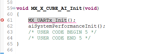

I am trying to run my project using X-CUBE-AI library and its throwing me this error. I am using B-U585I-IOT02A discovery kit.
"/STM32CubeIDE_1.10.0/Major Project/Debug/../X-CUBE-AI/App/app_x-cube-ai.c:61: undefined reference to `MX_USART1_UART_Init' "

This is the code snippet in app_x-cube-ai.c file which is throwing an error. It says undefined reference to `MX_USART1_UART_Init'. Can you please explain how to solve it?
‎2023-04-03 6:03 AM
If you look in the project I sent this function is defined in the main.c.
It means that you probably disabled in MX the USART1 that is needed to communicate back with the PC.
Just rectify your main.c and add the the USART/CRC/GPIO init from the ones I sent in the project.
Regards
‎2024-12-11 7:39 PM
same error with me , for some reason in the main.c the MX_USART1_UART_Init(void) function was declared as static , limiting its visibility to only the main.c file , so the app_x-cube-ai.c file cannot see it
