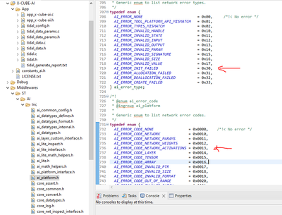

Dear Sir/Madam,
I have a trained CNN model converted to .TFlite file. The file has been analysed and validated on PC and Target. All are correct. Then an application template was developed. When I tried to run initiate CNN model with generated function " static int ai_boostrap(ai_handle *act_addr)", there is issue in this layer:
ai_bool cnn1_configure_activations(ai_network* net_ctx, constai_network_params* params) (Can not go deep anymore).  Always return false.  From ai_cnn1_init() returned an error type 48 and error code 19 as shown in the screenshot attached.
Would you please help me sorting out this issue?
QS

Julian E.
Hello @qs202310 ,
What version of cubeAI are you using. Try generating your project with the application template with the lastest version of cubeAI.
Can you share your model in a .zip file?
Your errors 48 and 19 correspond to initialization errors (in middleware/st/ai/ai_platform.h)
Have a good day,
