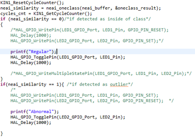

I'm trying to figure out how the 1_class library works. In the Emulator tab of the NanoedgeAI Studio software, I can see that the sensor indicates that the input pattern is detected as an outlier (outside the class considered), as shown in the following image:
But when embedded on microcontrollers, according to my code the orange LED should be flashing, but it's the green LED. I can't figure it out. Is my code correct? How can I retrieve the function output, which should be 0 for belongs to the class or 1 for outside of the class?
Thanks for your help.
A part of my code :

#if NEAI_MODE
uint32_t cycles_cnt = 0;
/* ############################## Partie Mode 1-class #######################################################*/
/*ici*/
KIN1_ResetCycleCounter();
neai_similarity = neai_oneclass(neai_buffer, &oneclass_result);
cycles_cnt = KIN1_GetCycleCounter();
if (neai_similarity == 0)
/*HAL_GPIO_WritePin(LED1_GPIO_Port, LED1_Pin, GPIO_PIN_RESET);
HAL_Delay(1000);
HAL_GPIO_WritePin(LED2_GPIO_Port, LED2_Pin, GPIO_PIN_SET);*/
printf("Regular");
HAL_GPIO_TogglePin(LED1_GPIO_Port, LED1_Pin);
HAL_Delay(1000);
/*HAL_GPIO_WriteMultipleStatePin(LED1_GPIO_Port, LED1_Pin, LED2_Pin);*/
if(neai_similarity == 1){
HAL_GPIO_WritePin(LED1_GPIO_Port, LED1_Pin, GPIO_PIN_SET);
HAL_GPIO_WritePin(LED2_GPIO_Port, LED2_Pin, GPIO_PIN_RESET); */
printf("Abnormal");
HAL_GPIO_TogglePin(LED2_GPIO_Port, LED2_Pin);
HAL_Delay(1000);
neai_time = (cycles_cnt * 1000000.0) / HAL_RCC_GetSysClockFreq();
printf("\n");
printf("NEAI learn return: %d.\n", neai_similarity);

‎2023-12-11 3:06 AM
Hi AkaPaDa_18,
In your if conditions, you should replace neai_similarity by oneclass_result, to make the orange LED blink when an outlier is detected.
You should also rename the neai_similarity variable by neai_state. Similarity has no meaning in 1-class classification.
Best regards,
Antoine

‎2023-12-11 2:59 AM
Hi @ABOIS.1 ,
Thanks for your quick reply. I already check the documentation that your are mentioned. My preoccupation is that concerning the below code, the orange LED (LED2) should blink instead of the green LED (LED1).

‎2023-12-11 4:25 AM
Wonderful!! it's works!!!
