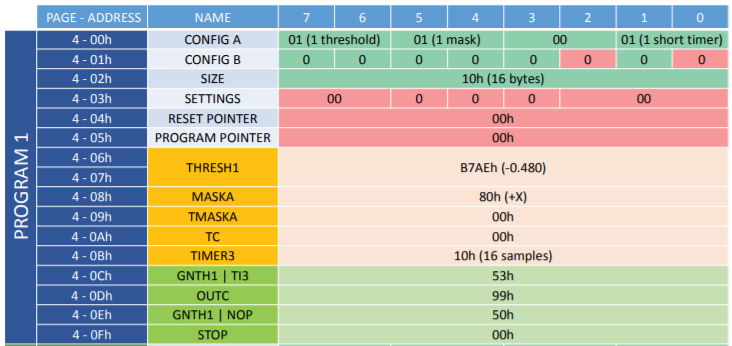

About the example at page 50: I saw it but it could be more helpful. There's a lot about what to do but not so much about why or how to relate it to Unico.
For example:
15. Write 00h to register 09h // Write 00h to register FSM_LONG_COUNTER_L
16. Write 00h to register 09h // Write 00h to register FSM_LONG_COUNTER_H
Why?
Each line should be disected and fully explained AFTER the functionality of the "routine" is fully explained.
