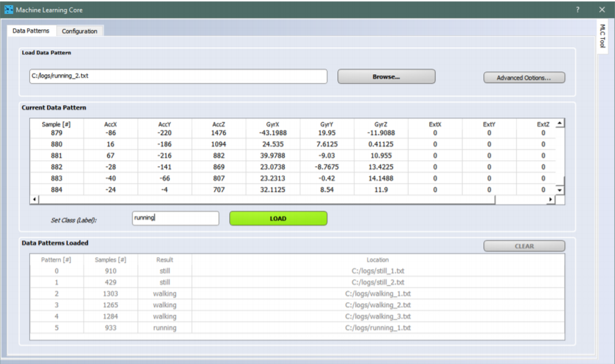

4. I tried to (almost) reproduce one of your videos for my purpose, so I did multiple captures of moving in the shape of E, and many moving like M. I used ODR52 and started capture before moving sensors in shape of letter then stopped capture. Again and again. Each movement was just above 1s so I got about 80 samples, I chose to use 52 of them.
QA: Should the many E captures be in ONE file (E.txt) as Unico appends new captures to same file, or in MANY (E1.txt, E2.txt, etc) files? It seems I can load them either way but I fear if I have multiple captures/file only first n samples from first capture may be used.
QB: Can I choose any values as "Decision Tree #1 Results? If my cases are "E" and "M" then I don't want either to be zero, so I chose 1 (E) and 2 (M) so that I should get "0" when nothing is recognized and 1 or 2 when E or M is recognized.
In fact I didn't get that at all: data always showed 2 when not moving and 1 sometimes; certainly not 0 when not moving and 1 when moving E and 2 when moving M.
Maybe one always needs an "everything else" case?

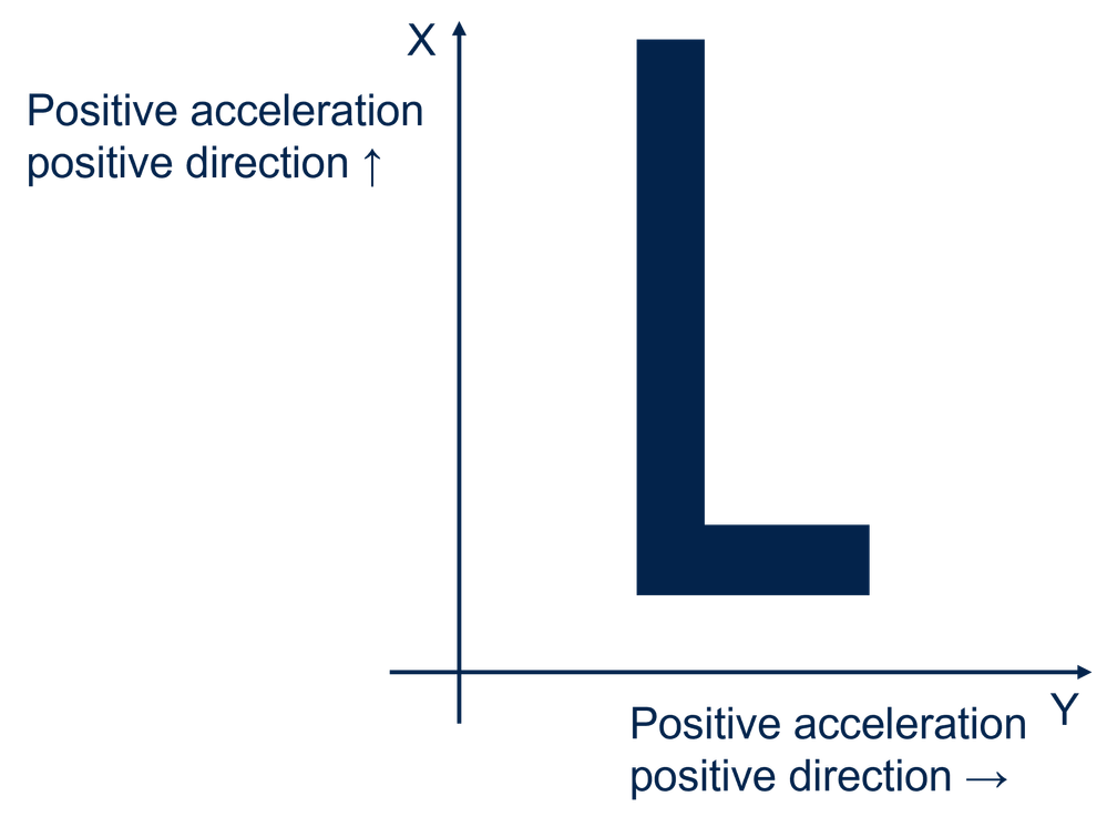

>> I think I was wrong about the lack of directionality, as acceleration and/or angle change do "describe" movement direction.
That's correct. If you move on a plane, and for example you are writing a "L", you can know the (relative) direction. But you have to pay attention to the reciprocal orientation between the letter (a "L"), and the reference system of the LSM6DSOX accelerometer.

I believe that your procedure of collecting many gestures ("E" and "M") is the correct one. The dataset can be uploaded in either way, but probably the suggested one is to use a single .txt for a single movement, and then label them separately, as shown in the application note AN5259, from p.22.
But I need to start sampling before/as that first movement starts, then recognize that it happened, and check that the next movement towards a different direction happens, and if it happens go on until all movements to make an L or M are recognized.
