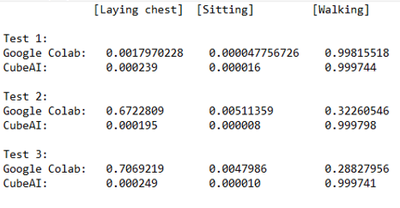

- I tested a couple of inputs manually to compare with result in Colab and this is where the problem seems to be (Test1 is OK), the results do not match quite a lot:
How this can be? The model in Colab is the same as STMCubeIDE.

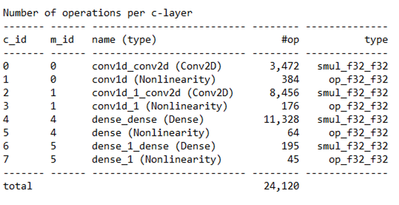

Side question: does AI Core transform Conv1D layers into Conv2D, as seen in the first picure? Can this possibly be the reason?

‎2024-07-17 2:02 AM
You can't expect the results to be binary the same as on one side you have code in python and on the target you have another implementation of the kernels in C.
If the accuracy for the validation on the target is ok with a significant dataset then the differences you are seeing are probably in the 5% of accuracy loss.
That said a cos of 0.968 on a significant dataset is not so good, we are expecting more in the range of 0.99 to 1.
Maybe you can share your model for a closer look at any potential issue.

‎2024-07-17 8:05 AM
Thanks for replying,
the error was that the dataset was segmented in different way in Python and in CubeIDE (which was my mystake), so the AI input was after all different in Colab and Cube. That is why it always predicted the same activity. If this wasnt the case, then the performance of AI Core would indeed be unnacceptable.

‎2024-07-17 9:58 AM
The sequence of sensor input data for model input batch (segment) was different between Colab and Cube, which was not obvious at first. After correcting the input batch format in Colab, now I get same results in Colab and Cube. You can perform "Validation on target" in CubeIDE using one-hot-encoded input data and UART and this will tell you how much the accuracy differs between your Cube model and Python model.
