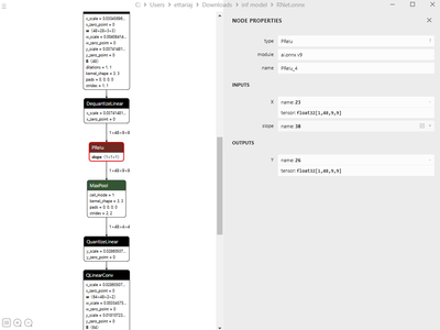

Hello @qiqi,
I do not reproduce the ?? issue.
Concerning the epoch being in SW, I we take for example the PReLU in your RNet, we can see that it uses float32, but an epoch can only be mapped in HW if the operation is supported and in int8:
You do get warning at the beginning at the report telling you that nodes are not quantized. Could you please try first to quantize your model and see.
Have a good day,
Julian
