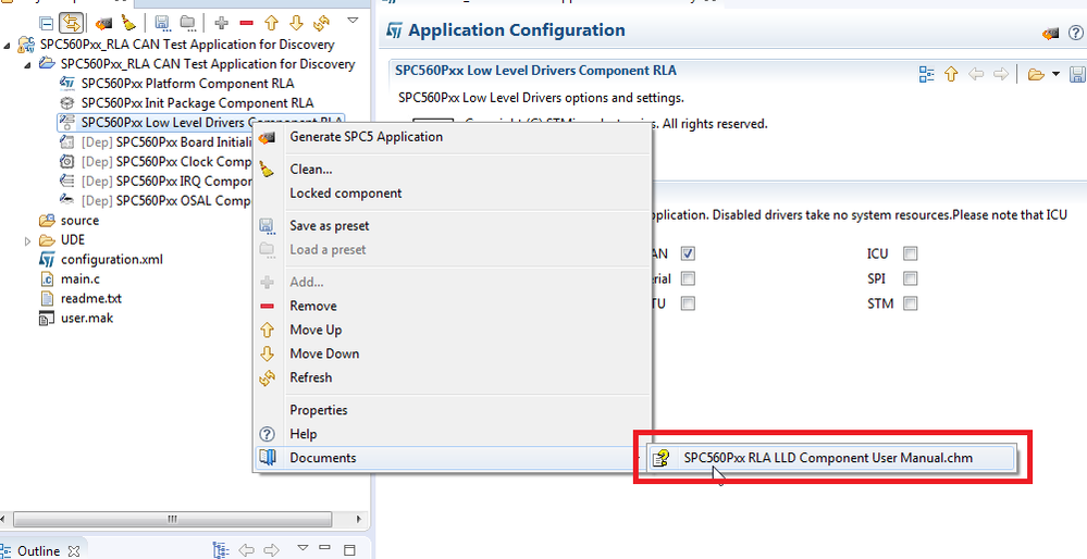

Hello Aditya ,
In SPC5Studio Components , there are some CHM files
Best regards
Erwan
