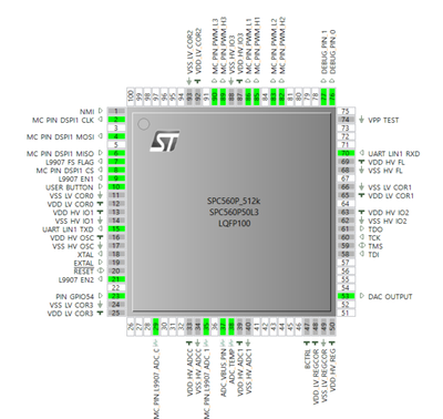

We are developing PMSM motor controller using  SPC5-MCTK-LIB sdk and SPC560P50L3 controller. We have Motor controller development kit and we are able run motor using devkit. Now we have developed a custom board using SPC560P50L3 and in the custom board, PWM gate drive pins are interchanges as following.
Pin No (SPC560P) Configuration in Example project and devkitCustom Board Configuration
82HS2HS2 (PWM_IN_H-V)   HS1 ((PWM_IN_H-U)
83LS2LS2(PWM_IN_L-V)    LS1 (PWM_IN_L-U)
85HS1HS1 ((PWM_IN_H-U)  LS2(PWM_IN_L-V)
86LS1LS1 (PWM_IN_L-U)  HS2 (PWM_IN_H-V)
89HS3HS3 ((PWM_IN_H-W)   LS3 (PWM_IN_L-W)
90LS3LS3 (PWM_IN_L-W)  HS3 ((PWM_IN_H-W)
So basically, we have interchanged High with Low side and Uvw with VWU phase.
Now, I need help in changing the PWM pins with respect to our custom board.
Currently we are using example project SPC560P50L3_MotorControl_STEVAL-TTM001V1 and in the example project pins are configured as following with respect to devkit,
We are using following devkit:
inverter board and driver board - STEVAL-TTM001V1 (https://www.st.com/en/evaluation-tools/steval-ttm001v1.html)
controller Board - STEVAL-TTM002V1 (https://www.st.com/en/evaluation-tools/steval-ttm002v1.html)
So, Pleas help us in changing  gate driver PWM pin configuration in the example project with respect to our custom board.
