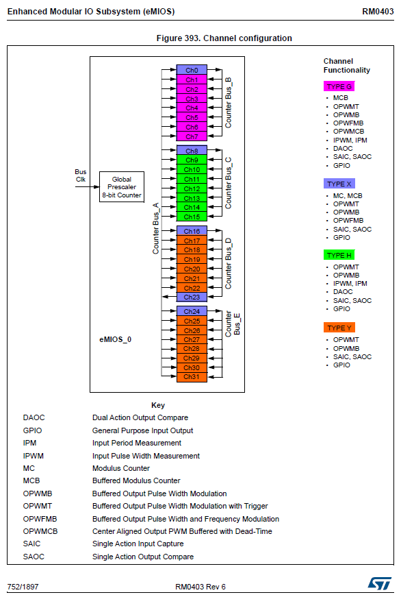

Nevertheless, it is not easy to comprehend, which group and channel number in the SPC5Studio Low Level Driver Wizard corresponds to the UC0-UC31 pins of the processor. According to RM0403 on page 752, the different channels support different modes.
Here as a picture for easy reference:
0693W00000DnE3YQAV.pngSo far so good. That's why I planned using pins UC13,UC14 and UC15 as IPWM inputs and using UC16 as OPWFMB.
In the configuration wizard groups 1-3 only allow OPWMB or OPWMT mode. And on the group 0 channels, IPWM is not a selectable option.
So my questions:
  • Is there a way to setup UC13,14 and 15 in IPWM mode with the LLD tool in SPC5Studio?
  • If not, how is the correct order of steps to manually configure the eMIOS channels accordingly?
  • Is it possible to set UC16 as output PWM mode while the other UCs are configured as IPWM?
  • In the PWM configuration seetings, each group has channel number 0 to 6. How does that correspont to UC0-UC31?
  • How do groups 0, 1-3 correspond to the picture above?
After reading the RM0403 and the datasheet of the processor itself, I still don't know how to set it up or if that is even possible.
Thanks in advance for an answer.

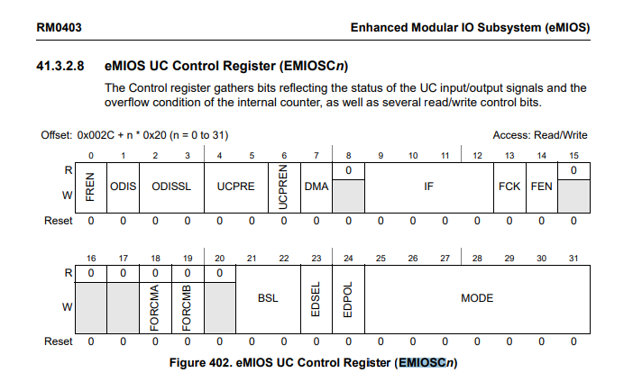

Hello ,
  • on LLD tool, it is not possible to setup UC13,14 and 15 in IPWM mode , only OPWMB and OPWMT are permitted.
Maybe , you can update the drivers to support IPWM
inplug low level driver and add implement IPWM configuration.
  • By using , this register eMIOS UC Control register , there is no specific order to configure your channel
  • I think yes , eMIOS UC Control register , you have to check your pinmap configuration.
  • eMIOS0 Group1 CH8-CH15 Group2 CH16-CH23 Group3 CH24-CH31
Best regards
Erwan

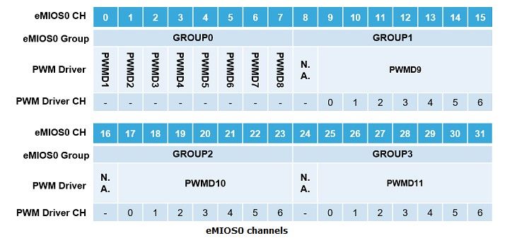

zambrano.luigi
Hi Christopher,
the relation between the eMIOS channels and the PWM low level driver channels is summarizing in the pictures that you can find in the document contained in the folder spc582bxx_low_level_drivers_component_rla/doc within your SPC5Studio test application.
As you can see from the picture, the eMIOS channels 8, 16 and 24 are not available (because there are used as counter for the other channels within the same group). In the current version of the driver for the channels of Group 1, 2 and 3 only the modes OPWMB and OPWMT are supported. Instead, for the channels of the Group0 only the modes OPWFMB (PWM) or SAIC (ICU) are supported.
Regards,
Luigi
