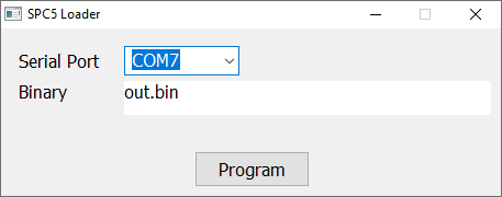

Step 3) spc5loader.zip
This is the PC tool to use with bootloader
***Do not use PLS anymore***
Assuming you flased my bootloader binary from step 2)
connect an USB cable from your PC to the MCU Dicsovery2 USB
launch the spc5loader tool and configure it with good COM and the application binary out.bin from Step 1)
*** Use out.bin from PIT application zip ***
0693W00000KcqSIQAZ.pngthen switch ON the board
only LED1 should be ON
and click on Program within 5 sec
if load works correctly, at the end you should have LED1 ON and LED2 ON
then reboot the MCU, you should see LED1 for 5 sec
and then the 3 LEDs should blink ever 1sec/2sec/4sec
Please do this step3 and let me know
BRs,
-Olivier

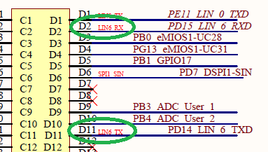

1) Now let's look at your bootloader program which is using LIN6 instead of LIN4
and pinmap PD14/PD15 instead of PA0/PG15
do you confirm ?
2) Let's look to your connections
0693W00000Kcz3WQAR.pngThere is a big 4*37 connector X9 on the side of your board
each pin named vertically with a character among ABCD, and horizontally with a number from 1 to 37
Do you confirm you connect to the other board using pins D2 and D11 ?
SPC584B LIN6 TXD D11 => RX on other MCU host
SPC584B LIN6 RXD D2 => TX on other MCU host
BRs,
-Olivier
Ravi S
Hi sir,
Yes sir I connected this LIN6 only. big 4*37 connector X9 D1 and D11 pin connected to other MCU.
Thanks
