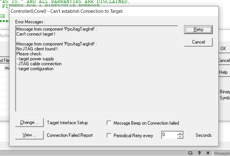

I am trying to upload a code to my SPC570S-DISP development board, but I am having an issue with the debugging tool UDE. I searched for this issue in the forum and I have tried all the solutions given and none of it work. When I try to debug from SPC5Studio I get this error,
And when I try to use the UDE STK tool I get this error,
Message from component 'PpcJtagTargIntf' :
Can't connect target !
No JTAG client found !
Please check:
- target power supply
- JTAG cable connection
- target configuration
I have created a case with ST, and so far no one has been able to figure out what the problem is. As I saw from the posts in the forum, many users are having this problem. Please be kind enough to look into this matter.

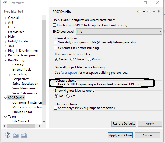

Hello ,
PLS Eclipse Plugins (32 bits) and SPC5Studio 6.0 (64bits) last eclipse ecore are not compliant anymore.
it worked only on SPC5Studio 5.8.1 (32 bits)
PLS should deliver a new plugin in Q1 202.
I recommend to use PLS in external use.
http://www.pls-mc.com/spc5-udestk-udestk
Best regards
Erwan

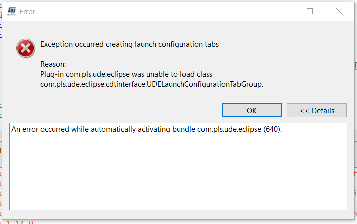

I unchecked this option. When the debug button is pressed, the UDE STK software launches. However, no file is opened, only the blank software window. Then I tried opening the debug.wsx and I get this error,

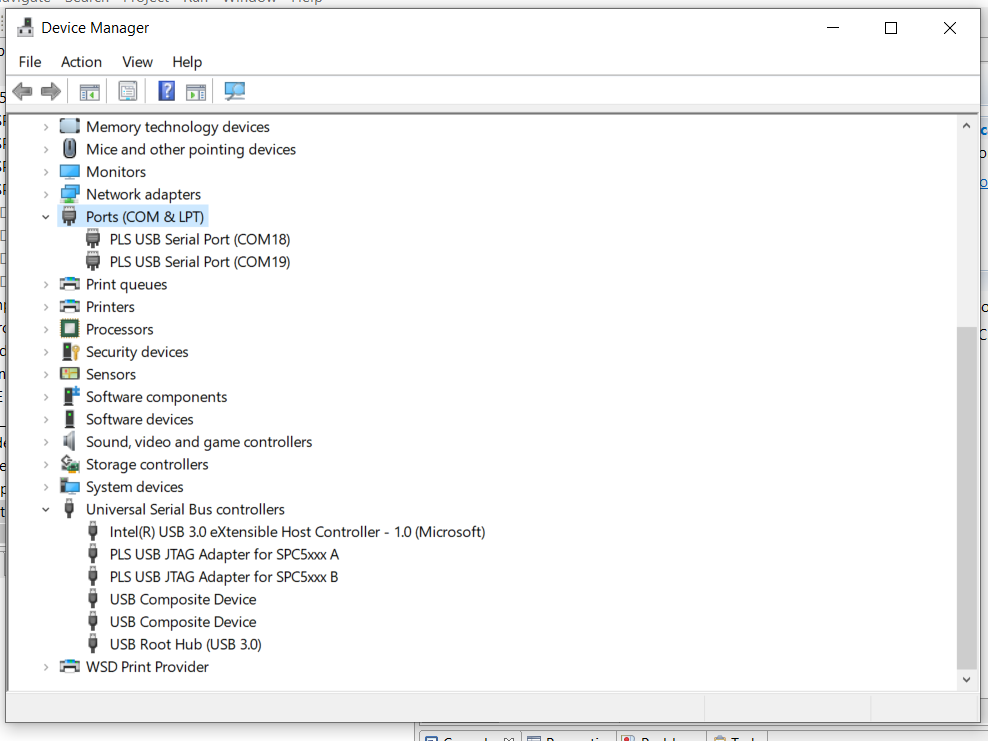

I am powering the board using a 12V power supply. Are there any settings that I should change in the target interface setup? I have uploaded the connection error log. I tried changing the .cfg file in the debug.wsx file from "spc570s_discovery_debug_jtag.cfg" to "stm_spc570s50_velvety_discovery_starterkit_debug_jtag.cfg" since it was stated in one of the discussions. I followed the steps to setup the VCP port for the device as well.
I contacted PLS as well. And according to them, it is a power issue. Please help me in this matter.
