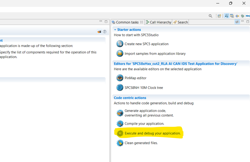

I have SPC58NH-DISP board for my application development. I am trying to program the board using SPC5Studion but I am unable to do it. For me "Execute and Debug Your application" task is disable even if in SPC5Studio UDE plugin is installed. UDE plug in is installed by using this link : "SPC5tools - http://spc5tools.spc5studio.com"".
NOTE: Board is connected and power supplied.
