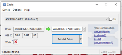

  • Driver mapping via Zadig:
    • Interface 0WinUSB (Microsoft) (also tried libusbK)
    • Interface 1USB Serial (CDC) (shows up as COMx)

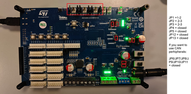

Hi Amal,
I think you have made some mistakes during openOCD driver installation.
Let me share a step-by-step installation guide so this procedure gets clearer.
This guide will also explain how to create a debug configuration from an existing project. (which is mandatory in order to program your MCU board)
After completing the installation, please make sure that the jumpers of your AEK-MCU-C4MINI are configured as follows:
Best regards,
Simone

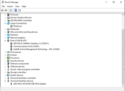

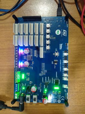

Hello SRomeo,
Thanks for the reply, it helped a lot in the installing of drivers.
In device manager i can see one as USB JTAG adapter, which was not available before.(pic uploaded)
I followed all the steps and still i am not able to debug or flash the code to the Mcu.
i have given a 12 v to mcu and connected via usb mini b with my laptop.( these are the hardware setup)
i am using the sample project from the auto dev kit studio- AEK-MCU-C4MINI- AEK_POW_BMSCCTX_2_nodes_chin_GUI_application for discovery.
I have connected 8 cells in series with the BMSCCTX with C0 to C8 and gnd. But my code is not writing in the mcu.
I will attach some pics for your understanding and hope you would provide me with a valid answer.

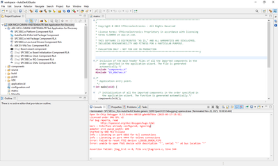

daynialkhan

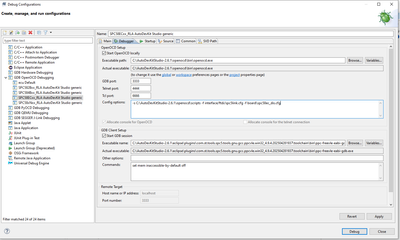

i have issue with run and debugging i have also updated the debug configurations! still i am getting error
Open On-Chip Debugger 0.12.0+dev-00318-g0e98d766e (2023-05-17-15:52)
Licensed under GNU GPL v2
For bug reports, read
adapter srst pulse_width: 100
Started by GNU MCU Eclipse
Info : Listening on port 6666 for tcl connections
Info : Listening on port 4444 for telnet connections
Error: failed to reset FTDI device: LIBUSB_ERROR_PIPE
Error: unable to open ftdi device with description '*', serial '*' at bus location '*'
Assertion failed: jtag_trst == 0, file src/jtag/core.c, line 344
what can be the possible error

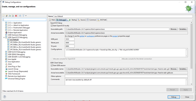

SRomeo
From the screen I see that your "config option" of the debugger tab is different with respect to the one in the documentation.
You should have just:
-s C:\AutoDevKitStudio-2.6.1\openocd\scripts -f board\spc58ec_dis.cfg
Make sure all the steps described on the guide I shared are followed @daynialkhan
Moreover, we cannot assure "Zadig" is installing the correct drivers.
I suggest the manual procedure,
Thanks

I have followed AEK-MCU-SPC5LNK_QSG_reduced.pdf step by step! but screenshot can be seen that i have only 2 ports! plus i have got same error board is already powered on
please help!!
Try converting your interface 1 to Usb serial Port.
I was able to pass this phase

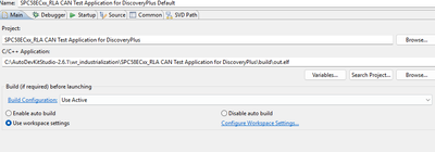

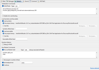

Take a look also to MAIN, STARTUP and SVD path tabs.
I'll share an example for reference:
-Project pointing the correct "project explorer" file (the demo needs to be in the workspace, already compiled)
-C/C++ application pointing to the .elf file of your demo  (into C//autodevkit_X/workspace_X/yourdemoname/build/out.elf)
MAIN tab:
Startup tab:
SVD tab (pointing to the SVD file corresponding to your micro)
Then:
1) connect the USB port
2) Switch on the 4MINI
3) Click on debug->debug configuration (using the discussed configuration and with the project already compiled)
4) Your project is flashad
If this doesn't work either then your board/USB port is somehow broken.
