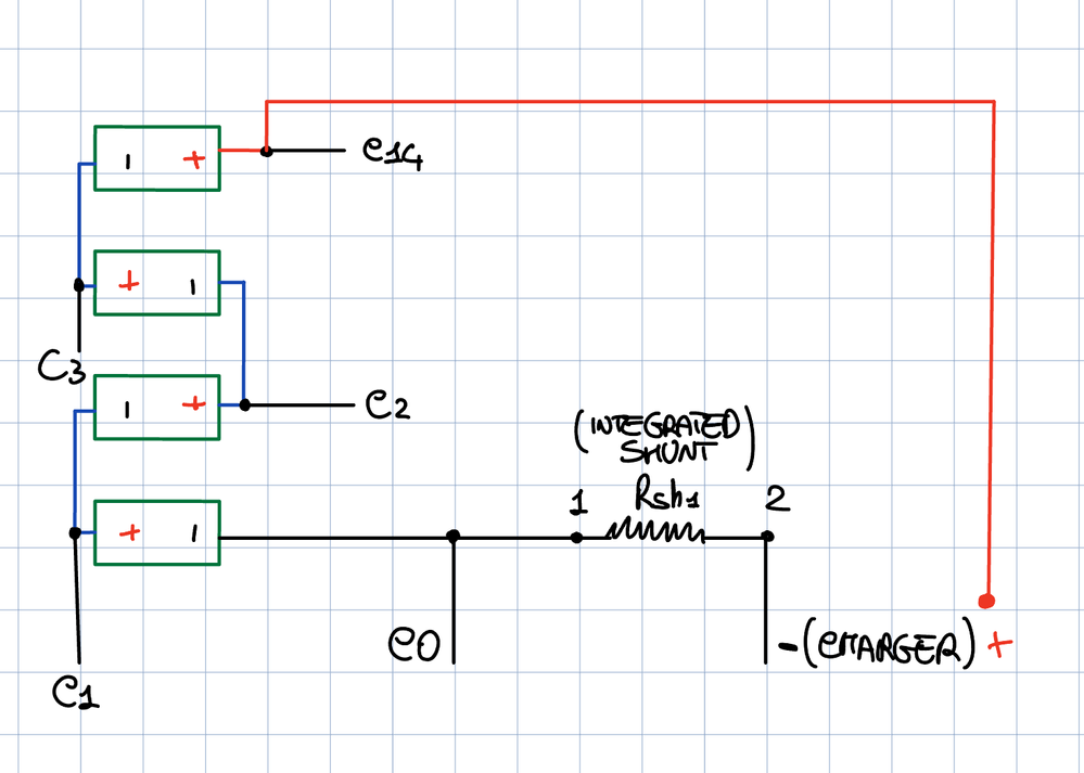

I connected the negative of the battery pack to cell 00, then the positive of the first cell to cell 01, then the other one to cell 02, the other one to cell 03, then I short-circuited up to cell 13 and connected the last positive to cell 14, connecting on one side of the shunt the negative of my charger and on the other side of the metal shunt the negative of the battery pack and cell 00.A39AAEBC-2695-4B63-B408-865A76C79F44.png

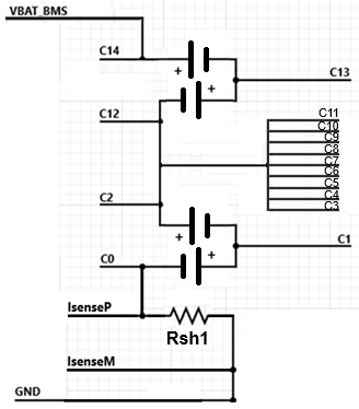

Then please, follow the direction already shared:
@SRomeo wrote:
1) Mount R135 (default Not Mounted)
2) Mount R138 (default Not Mounted)
3) Remove R136
4) Connect CELL_00 to  EXT_I_SENSE_P
5) Connect CELL_GND to EXT_I_SENSE_M
Warning: If you want to use only 4 cells (minimal configuration) instead of 14, make sure to short C11÷C3 together. L9963E device always requires the top 2 and the bottom 2 batteries of the pack.
So you have to modify your scheme as follow:

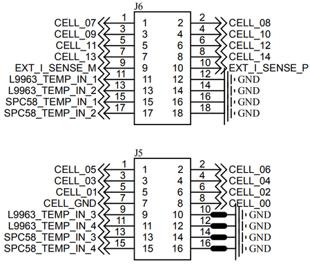

Below the Connectors J6 and J5 for knowledge:

antonio0101
OK, I changed the connections as you told me. As for the cell connections to the board, I'm fine. But now I don't understand why I have to fit those R135 and R138 resistors and what values ​​they must have to use the internal shunt. Can't I just put the shunt (and therefore the metal plate) in series with the negative line of the battery?
I'm a bit confused. The manual says that the internal shunt is Rsh1, or the metal plate. If I put the negative of the charger on one side, and on the other side I put cell00 and the negative of the battery pack, it should measure the current correctly.
