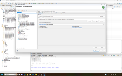

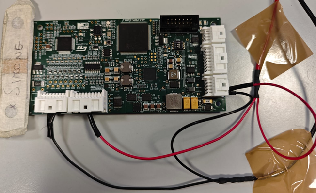

To enter in Debug mode with your AEK-POW-BMSLV you need to configure SW2_1 pin shortly after board powerup. This procedure is very tricky, especially when a battery pack is connected.
To simplify it I suggest connecting the board as follow to a power supply:
Then follow these steps:
1) Powe-up the board.
2) move the SW2_1 pin
from this state: (pin1 state 1) SRomeo_3-1757594607189.png
To this state: (pin1 state 2)     SRomeo_5-1757594844278.png
Now you should have entered "Debug mode"
3) Import the BMSLV project

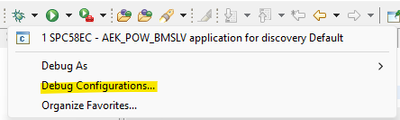

I.E.     SPC58EC - AEK_POW_BMSLV application for discovery
4) Click on Debug configuration
to configure and flash your device.
Make sure to check your configuration setup.
"Main", Debugger", "Startup" and "SVD" tabs have to be configured correctly
(Screens attached)

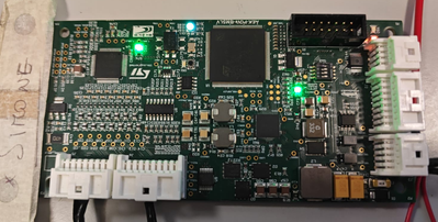

Board correct behavior resembles this:
With:
D15 -> blinking
DS2 and DS3 -> ON
DS4, DS5, DS6 and DS7 -> blinking alternatively

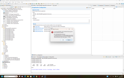

Hi, in the last few days I managed to get the debugging to work without making power connections on the J6 and J5 connectors, simply by modifying some paths that were not preset, the ones you also sent me in the zip folder. I wanted to ask you if the demo file writes to the serial port or not? Do you have any example code that allows me to test if the serial port reads and works?

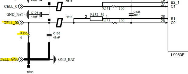

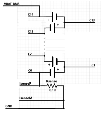

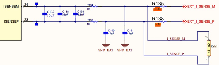

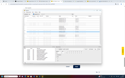

Hi, now it works well, the only thing I read is a current value that is always negative even if I charge the cells with the battery charger, I connected the negative of the battery pack from side 1 of the shunt, from side 2 cell_00 and the negative of the power supply that charges the batteries, but nothing happens.
SRomeo
Hi there,
The default configuration of our AEK-POW-BMSLV board have the "Current Sensing" section disconnected. (J6 pin 9 and 10 disconnected). 
To make use of it you should connect the R-shunt resistor to your battery pack, using a scheme similar to the following:
To do that, starting from the default BMSLV board you should:
1) Mount R135 (default Not Mounted)
2) Mount R138 (default Not Mounted)
3) Remove R136
4) Connect CELL_00 to  EXT_I_SENSE_P
5) Connect CELL_GND to EXT_I_SENSE_M
This way you'll be able to measure BatteryPack current.
