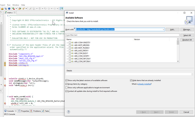

After installation of AutoDevKit Studio 2.2.1, you need to update some components.

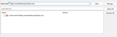

Just go in menu Help>Install new software and write the sever address:
autodevkit.spc5studio.com
Select all and proceed with the installation. Once completed it will ask you to restart AutoDevKit Studio.

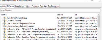

After the installation if you click on the 'already installed' link shown in cyan in the previous image you should see the latest installation AutoDevKit group feature version 2.3.1

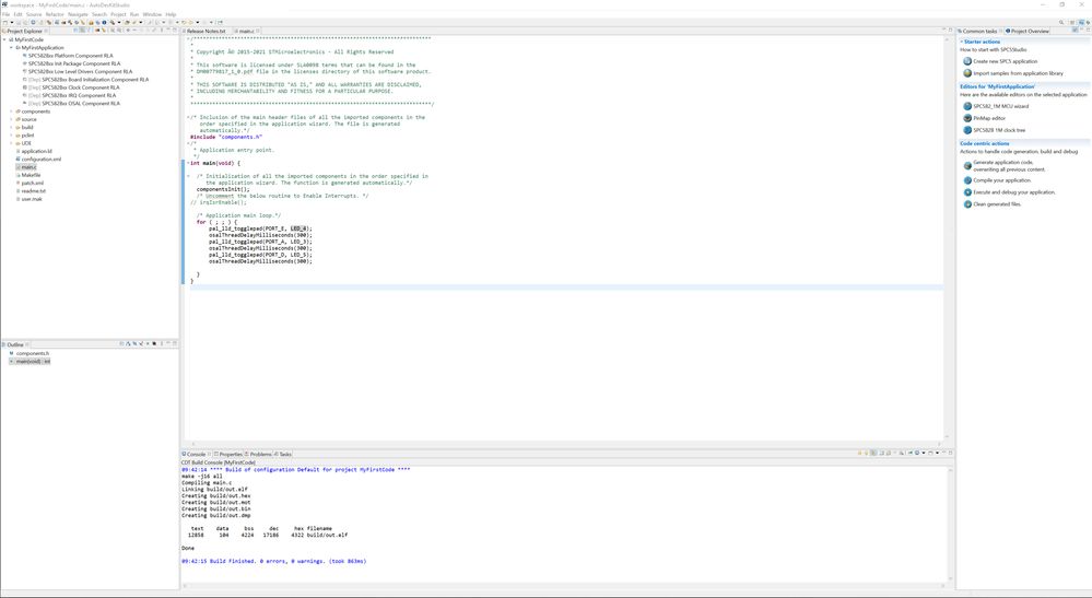

Now considering the MCU board you have the key low-level drivers primitives you need are:
/* Turn off the first led of the MCU board .*/
pal_lld_setpad(x,y);
/* Delay execution for given milliseconds*/
osalThreadDelayMilliseconds(number_of_millisenconds);
 /* Turn on the first led of the MCU board .*/
pal_lld_clearpad(x,y));

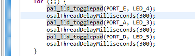

The pin configuration for a given example is:
These 4 functions in an infinite loop will toggle the LED of the board continuously.
An alternative example code to toggle three LEDs follows:

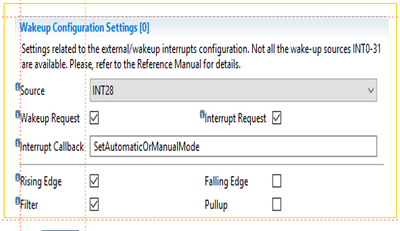

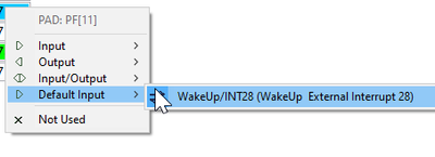

If you want to do it on button press, you should enable the WakeUP unit and set a callback to be invoked every time the button is pressed.
A configuration example below:
Then in the code you need to define the callback function outside the main function, called SetAutomaticOrManualMode() in the above case, and in the main code you should initialize the wakeup unit with the following command:
The second parameter is the name of the configuration you have chosen.
The Interrupt pin in the example above is configured with:

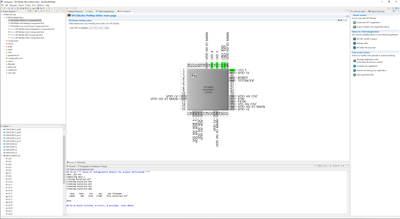

Ali5
Hello Max,
Thank you for your detailed explanation and code examples. I really appreciate the effort you've put in to help me understand the process of configuring pins and controlling LEDs on this board.

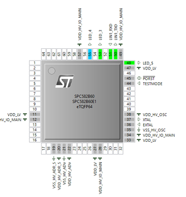

After reviewing your instructions and the code, I followed the steps to configure pins 48, 53, and 55 as outputs using the "eMIOS_0U16 (eMIOS 0 channel 16)" option in the pin map editor. However, I'm still not seeing the LEDs blink when running the code. I've double-checked the board.h file, and the PORT numbers (PORT_E, PORT_A, and PORT_D) match the ones you provided.
If you don't mind, could you please review the attached screenshot of my pin configuration in the pin map editor? I want to ensure that I've set everything up correctly.
Additionally, if it's not too much trouble, I would greatly appreciate it if you could provide an example of how to configure a button input and the corresponding code for handling button press events. I understand that this might be considered a basic task for professionals like yourself, but as a newcomer to this field, your guidance is invaluable.
