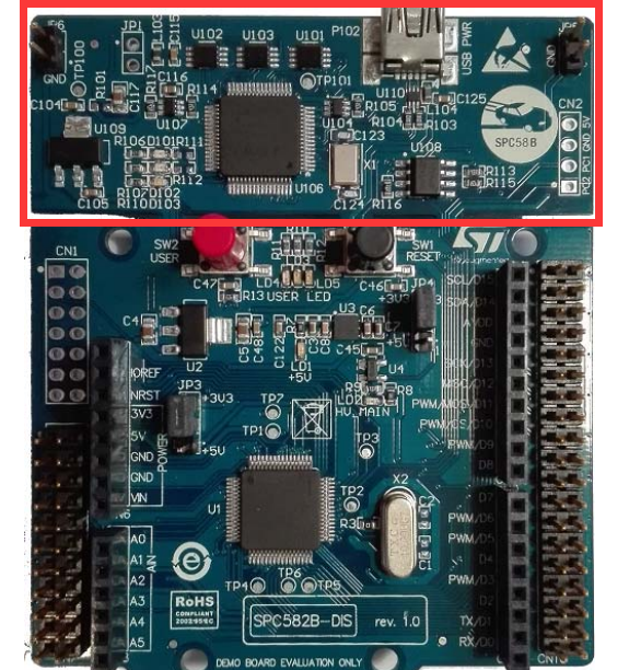

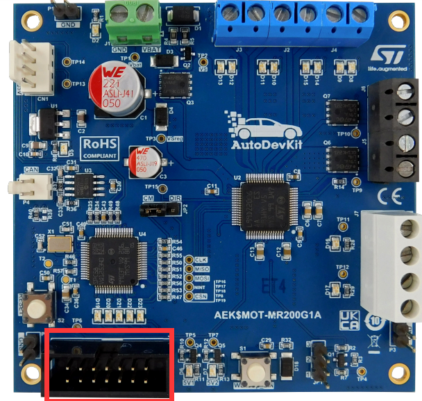

May I use the onboard debugger on the SPC582B-DIS Discovery board to download debugging programs for the AEK-MOT-MR200G1 development board? Can you tell me which specific pins need to be connected? As shown in the following picture!

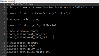

The following changes are required for programming and debugging the AEK-MOT-MR200G1 board with OpenOCD:
step 1: Under C:\AutoDevKitStudio-2.2.1\openocd\scripts\board open the file spc582b_dis.cfg
step2: at line 12 insert: reset_config srst_push_pull as showed in the image below.
step3: save the file.
step4: program and debug your code using OpenOCD in AutoDevKIt Studio
Thanks,
AutoDevKit Team
