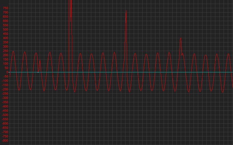

Dear fellow Devs,
I got a problem using the PDM to PCM library. While it seems to be working fine for a single conversion. There seems to be some kind of gap and noise between the results.
The picture below shows a 440Hz sine wave.
The class i wrote looks like that:

2023-04-20 8:45 AM
I found the error. Its working perfectly now.
This line was wrong:
uint8_t DATAPOS = Complete * Datalength/2;
Correct is
uint16_t DATAPOS = Complete * DataArraySize/2;
