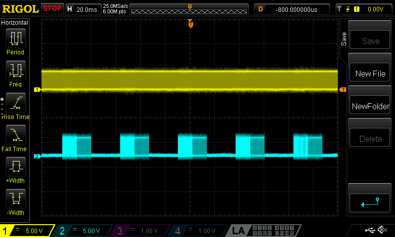

Sound is deformed and too slow.

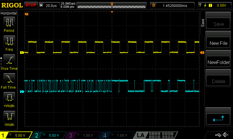

When I connect oscilloscope I can see that audio signal is generated only in 1/3 time.
_legacyfs_online_stmicro_images_0693W00000bj3nJQAQ.pngWhen I checked LRCK i SDATA signals - reason is clear.
_legacyfs_online_stmicro_images_0693W00000bj3nTQAQ.pngBelow you can see the most important code:

What can be the reason of this I2S behavior?
MLemb.2
Thank you for suggesions. Debugging with sinewave was helpfull :)
Finally I founded 2 problems:
1) I have int16_t type buffer (2 bytes), but function f_read need amount of data to read in bytes. When I sended AUDIO_BUFFER_SIZE / 2 it read only 1/4 buffer. I change it to AUDIO_BUFFER_SIZE to fill half buffer.
2) I change sampling frequency of file and I2S configuration to 22kHz.
After that sound is playing without deforming and at the right speed.
2 REPLIES 2

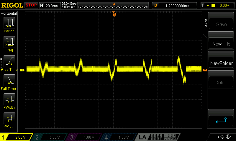

I'd probably opt for a larger buffer, and align the data reads
The header read will knock it out of alignment, so perhaps you can just zero it out, or figuring out a different buffering scheme.
Benchmark the reads, make sure you have the bandwidth.
Check I2S with a sinewave you generate.
MLemb.2
