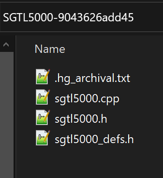

Here, you can find the project I don't know if it can open with STM32Cube IDE but I guess so. Thank you for your helps.

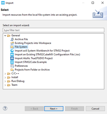

The original project looks like for SW4STM32. Try to import is as SWSTM32.

Yes. In that menu, select "import acv6 System Workbench.... project"

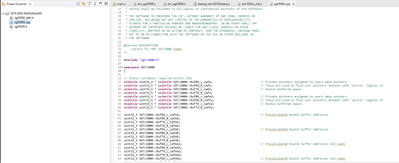

Probably I didn't do the right import method, I can't compile the project also.

Your RAR file doesn't include the whole project, just a few files. No chance of it working like that.
Guru
I couldn't get it to work either. You can always create a new project for the appropriate chip then replace all the files with the ones in your project.
Sorry, in this forum I can't send a ZIP file (which contains all the files) and I converted the ZIP file to RAR online. That why missing files.
