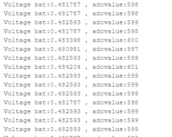

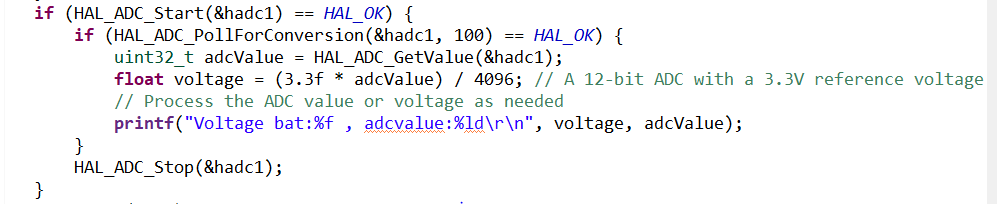

i'm using STM32G070, The firmware i have programmed converts the analog voltage to didital using ADC. the code is below:
_legacyfs_online_stmicro_images_0693W00000dDX43QAG.pngthe values i get from this is :
OUTPUT:

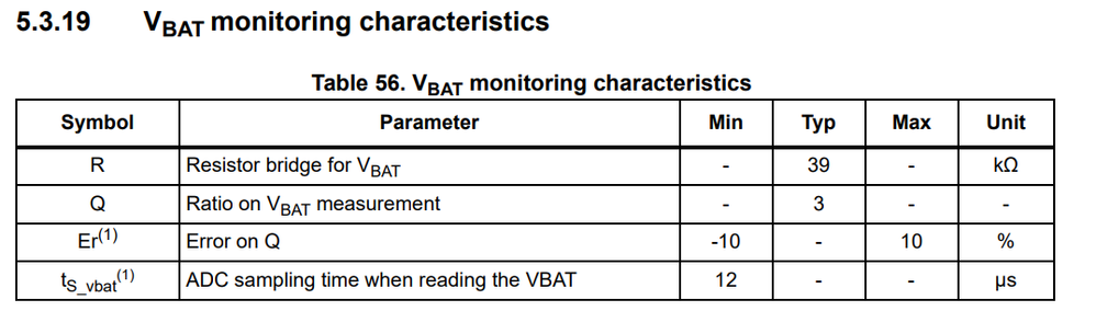

_legacyfs_online_stmicro_images_0693W00000dDX48QAG.pngIn the datasheet it is mention that a resister bridge for VBAT is 39K ohm which has ratio 3 on VBAT measurement .
_legacyfs_online_stmicro_images_0693W00000dDX4IQAW.pngso according to this the ADC value should be around 1365 which wil give us a voltage vaue of 1.1 but the result is voltage:0.48 and adc value:600.
please give me any suggestion, whats wrong with it.
thanks in advance.

    I would do:
    1- Configure the ADC and perform calibration if possible
    2- Do your Vbat mesurement, the real value you will sense is Vbat / 3., the measurement is respective to Vdda for 2047 full scale 12 bit value. (3.0, 3.3, 3.6V etc... )
    3- Run a Vref measurement to deduct VddA value in mV
    4- Walk back the path to deduct accurately Vbat.

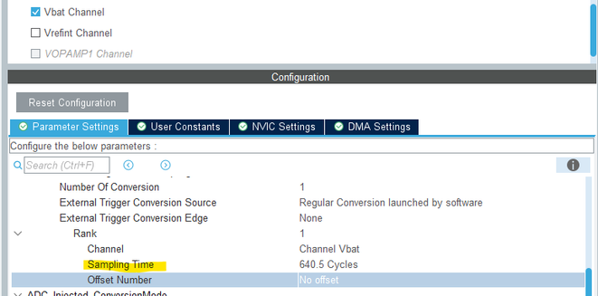

    Change the sampling time. I used the maximum value 640.5 cycles but you can play with other values. But I know the minimum (default) does not work as I get a lower voltage like ~1V.
    I did a initial calibration before the main while loop.
    HAL_ADCEx_Calibration_Start(&hadc1, ADC_SINGLE_ENDED);
    Measure the VREFP voltage and divide that by 4096 to get the ADC resolution.
    #define ADC_RESOLUTION (3.259 / 4096) // my board measure 3.259V
