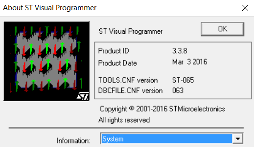

yes that is what I thought too, but its not starting after I use this file. Sorry I can't send you this .hex file but I can try to create a new one with the same effect. I attached a picture (003) with all my settings (removed the .hex file from the screen and the names). Also you see in picture 0011 more warnings.
The tool version is:

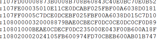

I tested it with STVP 3.3.9 and have the same problem. I think If the full memory size is 155 kB then the hex file is not created properly and i should check more IAR workbench.
This is displayed in STVP:
and the hex file shows:
I think that is the problem that the STVP dont know the range, and the hexfile ends with:
and this is the last address that STVP shows as warning.  I guess the problem is not STVP more IAR Workbench that creates the file.

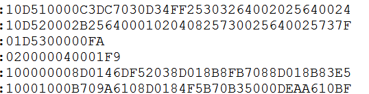

I create the file with IAR Workbench
I found this jump in the hex file this is the problem I guess
In STVP it looks like
Posted on February 03, 2017 at 16:08
OK, i don't remember very well the hex format but there are offsets...
So, the addr you see are not always the exact addr.

You're right i think the offset at this position is the problem.
Ah okay didn't see that option.
Thank you for the file and the help, I check IAR software for the problem
