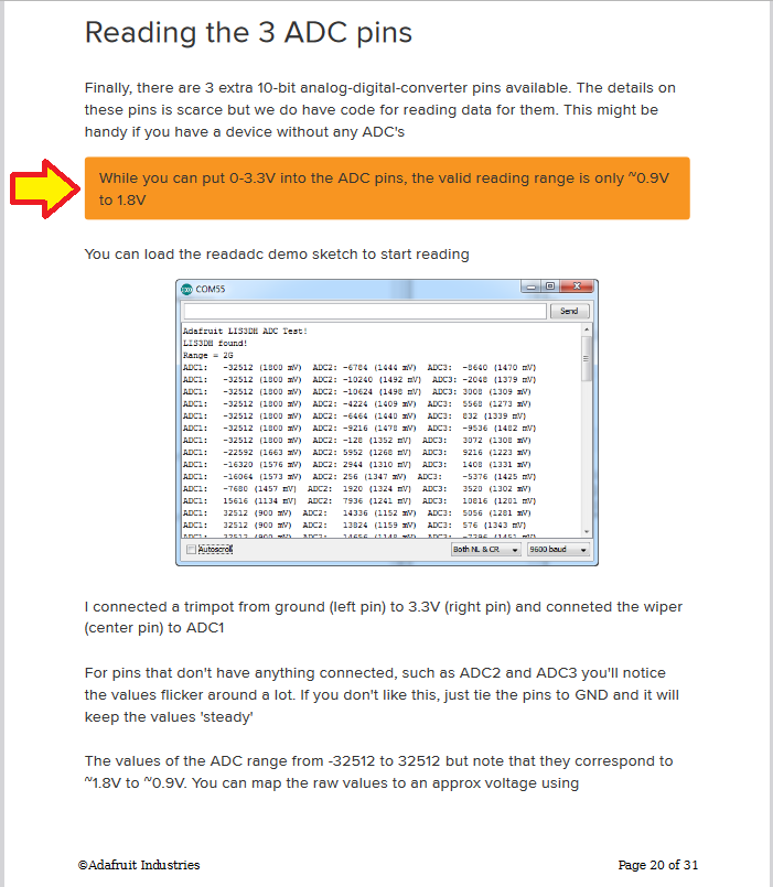

Thanks for your reply. Attaching the C file here, which primarily does the job of initializing the I2C and setting up the registers one by one.

One observation I made here - https://cdn-learn.adafruit.com/downloads/pdf/adafruit-lis3dh-triple-axis-accelerometer-breakout.pdf
Is that input range is 0.9V to 1.8V. As shown in attached image.
What I am supplying is 6V divided by 7 i.e. 850 mV. Maybe that is a root cause.

Actually in the DS the input range is 1200mV +-400mV, so your power supply (850mV) is within the range. However, if in the file attached it is state that the reading range is 1.8V-0.9V, it could be like this. You can try to read the value using 10-bit resolution and see if something change, or switching the power supply, if you can.
Do you have an example of output data, represented like the picture that you attached in your answer?
