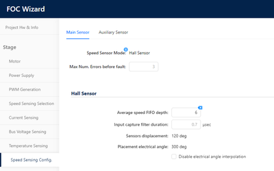

Hello @CWern.1,
Could you decrease the Average speed FIFO depth to 6?
If you agree with the answer, please accept it by clicking on 'Accept as solution'.
Best regards.
GMA
