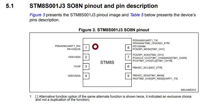

How to read the pins map of STM8S001J3?
MQi.1
Senior II
I have a chip with 8 pins, but I could find the start sign for pins order, should I start from left-bottom or left-upward corner?

There was no RST pin, if I want to program it with ST-Link V2 in SWIM, how to connect "RST" pin?
Not really my part, I suppose you could gate the power to it, and reset it that way.
If its low power, power it via the NRST pin.
NSidd.1
