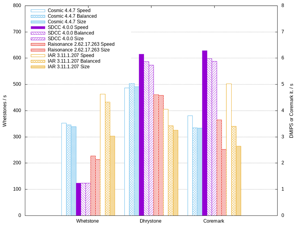

A while ago I did a comparison of these four compilers for the STM8:
http://www.colecovision.eu/stm8/compilers.shtml
I intend to update it soon using current versions (already redid the experiments for SDCC and IAR, but still need to look at Cosmic).
Here are some preliminary results in benchmark scores (using current SDCC, IAR and Raisonance, but Cosmic from two years ago):
All compilers have been set to maximum standard compliance and strong optimization. Optimizations goals: Code speed, balanced and code size.
