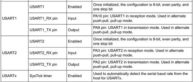

Why you dont use SWD? And 100k pull for what?
AN2606 say use one of
and init Pattern 1 (described in Table 2). Table 127
show your schematics
‎2024-04-26 9:48 AM
As mentioned the design is done.....
see page 39 AN2606 recommendations
regards..
