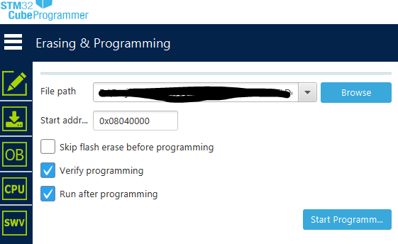

I have been trying to make a custom bootloader for STM32F413.
I use STM32CubeProgrammer, USB DFU
Although​ I have succeeded to make a custom bootloader for another MCU (STM32F412), it's first time that STM32CubeProgrammer erase an unexpected address.
I just wanted to use 0x0804 0000 as start address of application.
0693W00000GZjEMQA1.png​
But, STM32CubeProgrammer ​implemented like the log below

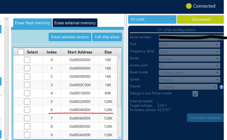

Hi, Pavel A.
You are right. but I have already checked it.
I referred to the RM0430 Reference manual because i used a STM32F413ZGTx.
I even checked it using CubeProgrammer and ST-Link.
0693W00000GZreXQAT.png​
So I have been thinking that STM32CubeProgrammer is confused when using USB not ST-link.​
I want to know why...
