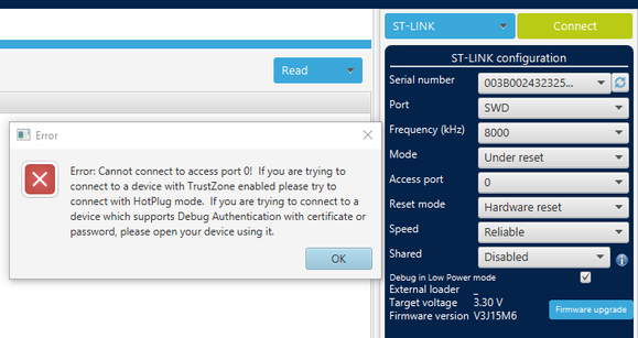

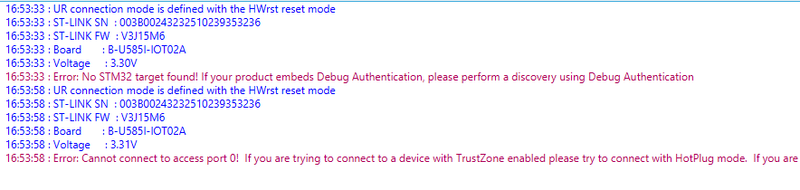

Hi, I get the below error when trying to connect to my B-U585I-IOT02A board in "Hot plug" and "Hardware reset" modes, whatever is the frequency. I get the same error even with BOOT0 High.
I'm using STM32Cube Programmer v2.17.0
Connection is successful only when I keep on pressing the reset button, but there is no option byte set and any attempt to set option bytes fails.
Thanks in advance for your support.

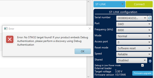

‎2024-09-26 8:41 AM
Still this error:

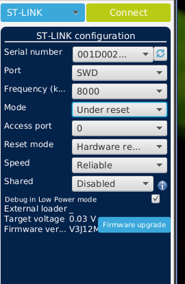

So my last 2 ideas :try connect under reset

- Trying to connect Under Reset raises the following error:
