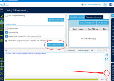

In automatic mode, when connecting a new circuit board, it will crash after a while.
daguo
In addition, can the content of the ob command be locked to prevent accidental modification
astrabestan
The program "SetupSTM32CubeProgrammer_win64" for the Gaggiuino project cannot be installed on my Hp Victus windows 11pro computer. It stays in the last step (step 8 of 9).
daguo
Can we add an indicator light for the next version, with red indicating write failure, green indicating write success, yellow indicating wait for connection, and flashing indicating write in progress. thanks
