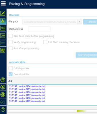

I have detected a problem with the v2.15.0 (64 bits) when flashing a STM32L475 MCU.
The message 'sector nnn does not exist' appears repeatdly when erasing sectors when flashing the device.
This only happens with v2.15.0., and then the device last a lot to be flashed and if there were some preserved flash areas, they are erased
Nevertheless, if v2.14.0 is used, the update procedure is completely carried out.
So, which is the problem? Is this issue already identified?

Hello @dtarrago,
Sorry for the delay. The issue with erasing sectors is a known and our development team is currently addressing it internally ticket: 176977. For the flashing time concerns, the issue is already fixed, I suggest using the latest version, STM32CubeProgrammer v2.16.0.
