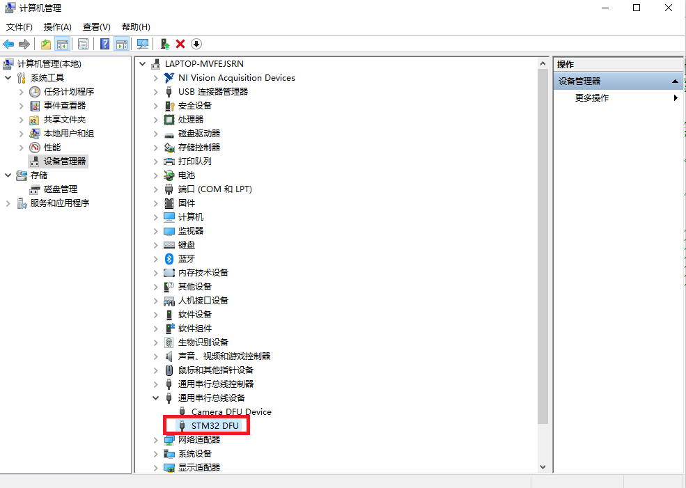

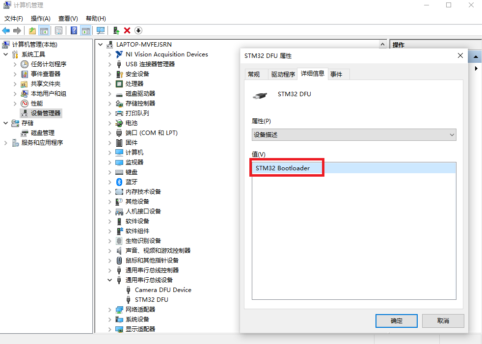

After download the example code to stm32f103, and plugin USB to host PC. the device can be enumerated as STM32 DFU in host Windows (attachment is the screenshot of device property in windows).

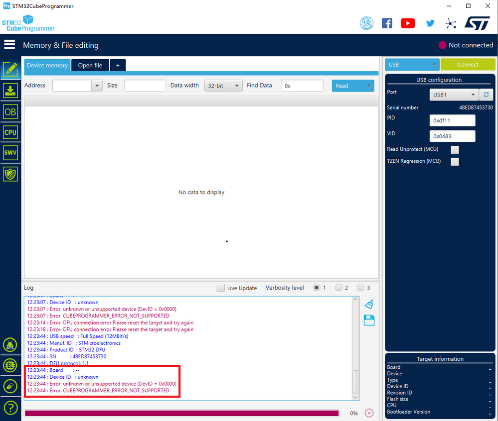

Then, I open STM32CubeProgrammer, select USB interface. The USB DFU device also can be found, with serial nmber / VID / PID as expected.
However when I click connect, the status dashboard shows the device ID is unknown, and CUBEPROGRAMMER_Error_Not_Supported. (Attachment is the error screentshot).
My question is :
1) Whether the Device_Firmware_Upgrade example, with STM32_USB-FS-Device_Lib_V4.1.0, is supported by STM32CubeProgrammer? Or I need to use the old DFUSu_Demo.exe to download?
2) If it is supported, why there is a device ID unknown error? Actually the VID/PID and version number is right as expected.
Do I need to change the Device_Firmware_Upgrade example code, and modifying the descriptions?

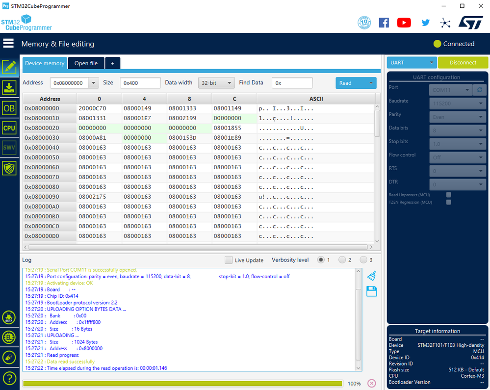

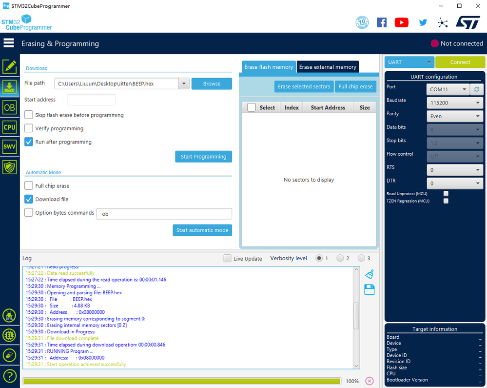

B) If I changed to UART interface in STM32CubeProgrammer, the function is OK. I can connect and also download code to stm32f103 correctly (attachment is the status screentshot).
