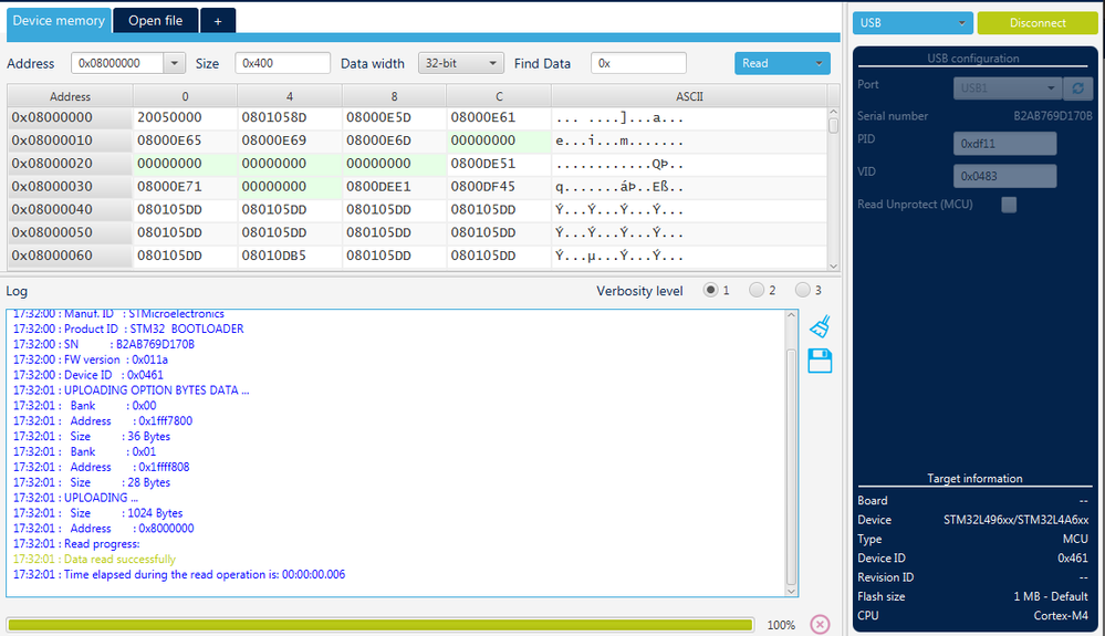

I'm trying to update a micro over DFU (USB) mode since we don't always have access to the STlink programmer.
I managed to start the unit in System Memory mode by reading a backup register at startup and jumping to system firmware if it's a certain value:

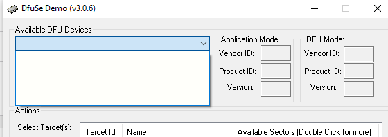

The thing is, the unit restarts in DFU mode, at least the PC says so:
But DfuSeDemo won't give me the option to use it:
However, it seems that STM32Programmer works:
Questions:
  • Can I use the STM32 programmer to update the user flash with my HEX or DFU file? But then... How do I exit DFU mode????
  • Is there a reason why DfuSeDemo doesn't work? Is there anything else I need to worry about? That one has the handy "leave DFU mode" button.
Any hints are greatly appreciated.

Hi all,
I just noticed that this has been solved elsewhere:
https://community.st.com/s/question/0D50X0000BI0NJhSQN/dfu-bootloader-device-not-showing-up-in-dfuse-demo
Thanks!
