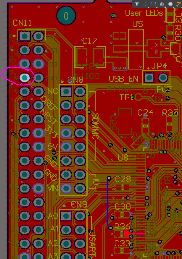

>>Does behaviour change if BOOT0 is strapped to VDD? There's a jumperable spot on the side of CN11
Going to try this
Edit: I soldered a wire from BOOT0 to 3v3, then i connected the USB, i get the same results as before.
How do i know the mcu is in ROM system bootloader? i connected an USB cable to the USB OTG port and cubeProgrammer couldnt detect any DFU port.
