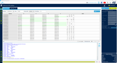

I have a NUCLEO-H7S3L8 board, and I am unable to debug any of the projects. I receive a sigtrap error upon debugging. I have tried multiple projects in ST's Github.
 STM32CubeH7RS/Projects/NUCLEO-H7S3L8 at main · STMicroelectronics/STM32CubeH7RS
All projects have the same issue.
After further investigation, we have determined that the default start address for the application is incorrect.
If I make a fresh project and select the chip itself rather than the eval board during project setup, I am able to debug.
Is this a known issue with this NUCLEO board?
Is there a way to change the address so we can explore the example projects?

Hello @mƎALLEm, Thank you for your reply.

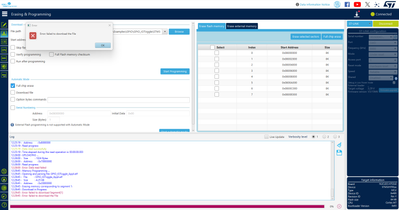

I have confirmed the Boot_XIP.hex is flashed on my board.
I then flash the GPIO_IOTOGGLE_Appli.elf file and receive this error.

From this screenshot we cannot see what you upload as file:

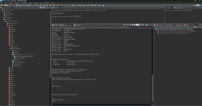

If you download the application with CubeIDE what do you get?
In CubeIDE, when I debug I currently have this error.
Debug Configuration is setup as mentioned in the README.md matching the photos I previously posted.
