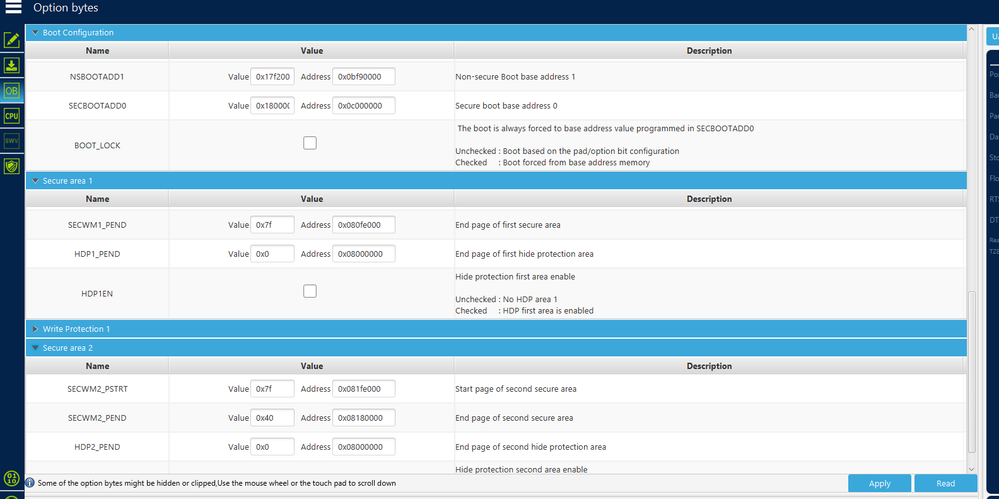

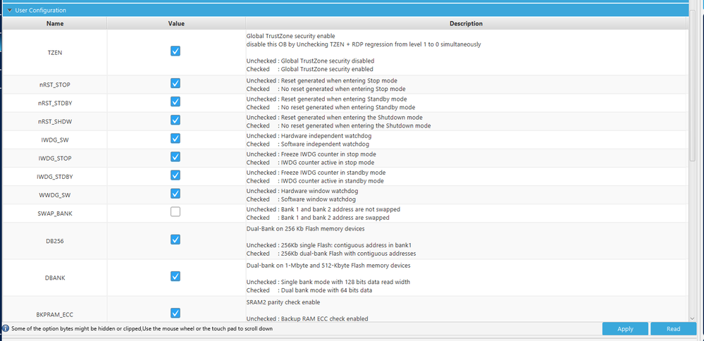

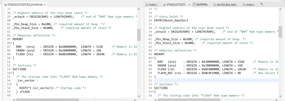

I am using MB1549C devkit for STM32U5. I have enabled trust zone and created one application.
Now I wanted to update firmware via native bootloader over UART.

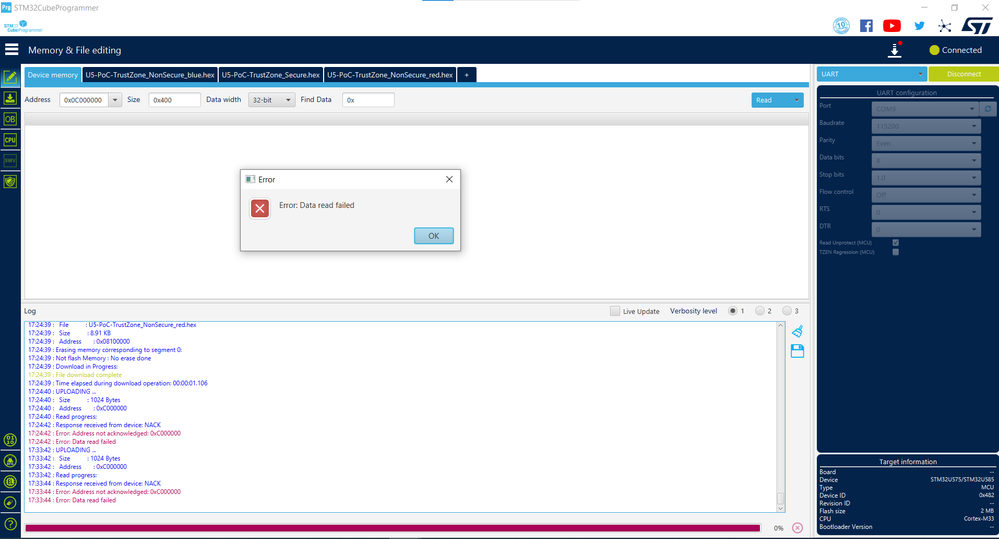

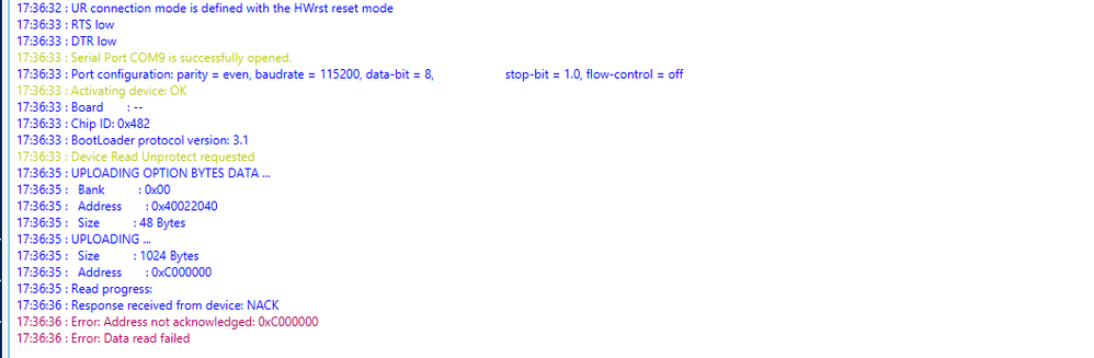

I have tried to connect it over UART2, I got read error over 0x0C00 0000 where secure firmware is loaded. even I am not able to erase firmware. I am able to read data from 0x0810 0000.
Here my secure and non secure code .ld file mapping.
_legacyfs_online_stmicro_images_0693W00000bjIIGQA2.pngCan you please guide me, How can I update firmware of mcu which has trustzone enabled via native bootloader using uart?

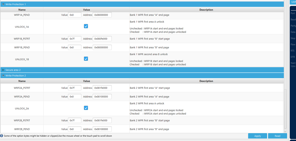

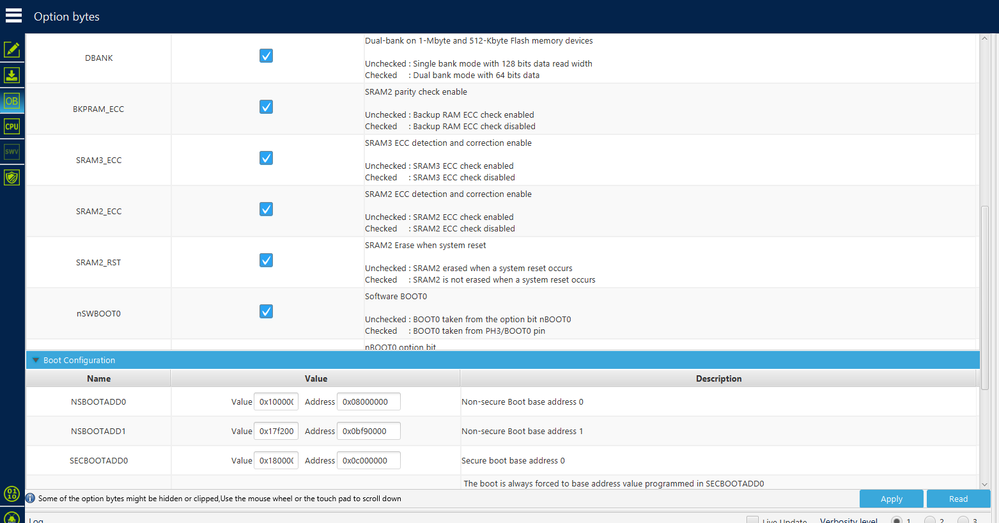

Please check option byte of needed. I have attached image.

You said : "I got read error over 0x0C00 0000 where secure firmware is loaded. even I am not able to erase firmware."
  • In fact, you must want to access this secure address from a non secure zone. What is your RDP level ?
To answer your question : "How can I update firmware of mcu which has trustzone enabled via native bootloader using uart?"
  • The best solution is to use X-CUBE-SBSFU (Secure Boot and Secure Firmware Update). That expansion package allows to update the STM32 microcontroller built-in program with new firmware versions. The update process is performed in a secure way to prevent unauthorized updates and access to confidential on-device data. You can find more information about X-CUBE-SBSFU here.
  • If the Trustzone isn't necessary in your application, you can also disable it.
