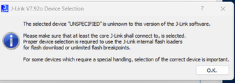

I've was following this tutorial on Jtag locking for stm32h573RI using j-link.
link to tutorial: How to enable RDP-like product state flash protect... - STMicroelectronics Community

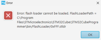

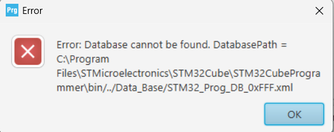

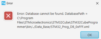

I made it to the updating the product state to 17 and was in the process of reconnecting under hot plug mode, however I didn't have success reconnecting.
I get these 4 errors:
To Note:
I was able to flash initially with no issues.
I've been trying to update the jlink version on the stm32cubeprogrammer and have had no luck
I have updated my jlink version locally to 9.18v
Thank you for the any suggestions :D

Hello @A_Bit_More,
I have tried reproducing this behavior on my side, but I wasn't able to get those popups when reconnecting using Hot plug mode after setting the product state to 17.
Is it possible to provide more information (firmware version, J-Link used etc..)
It is also important to note:
-Provisioning is not yet supported by J-link.
-The tutorial is made using ST-LINK.

More info:
I was using a custom board and a dev kit.
The custom board only has swd connections, which is why I was using jlink.
This is where I was getting my errors above, it just won't connect anymore.
As for the dev kit, I was using the st-link to follow the example.
On the step to regress, my ST provisioning integrity status:0xf5f5f5f5
and I'm stuck on this step from the example.
From what I was able to figure out my dev kit is locked and there is no way to get it out of this state, correct?
