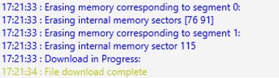

When I downloaded a .hex file to my STM32H563VGT6 (1MB Flash) using STM32CubeProgrammer v2.20.0, I encountered an issue where it would erase the wrong sector. For example, as shown in the image below, it was supposed to erase sectors (76..91) and sector 115, but I found that the contents of sector 27 is erased.
I also try to "Erase selected sectors" (76..116) manually, but sector 27 still be erased.

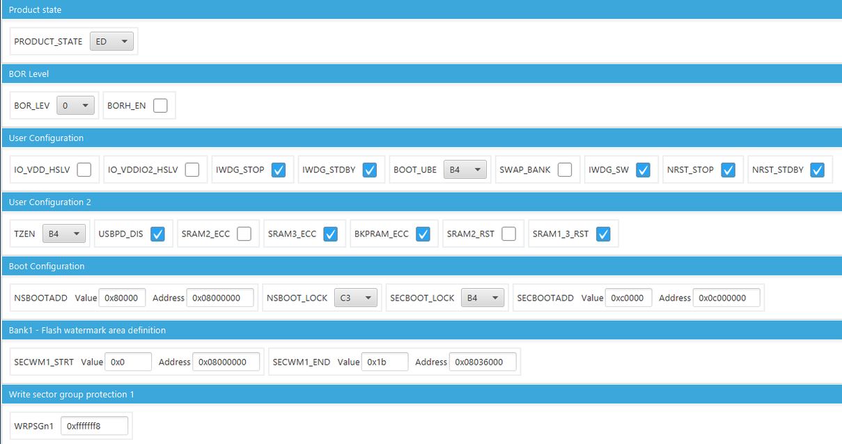

As you mentioned, my TZEN setting is enabled.
However, even when I switch to Hot Plug mode to download .hex files, the problem persists.
Does this problem only exist in the STM32CubeProgramer GUI program? Does the STM32CubeProgramer CLI also have this issue? Are there any suggested workarounds?
Thank you.

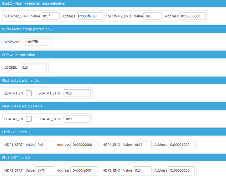

Also, below are my option byte settings for your reference.

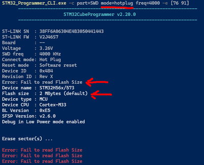

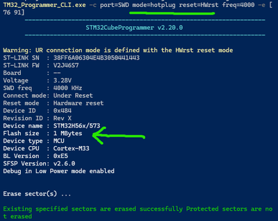

Hi Aziz,
1. I find CLI using hot plug mode with software reset can't read the flash size  
> STM32_Programmer_CLI.exe -c port=SWD mode=hotplug freq=4000 -e [76 91]
2. I change the reset mode to hardware reset, then the CLI can perform the erase command
> STM32_Programmer_CLI.exe -c port=SWD mode=hotplug reset=HWrst freq=4000 -e [76 91]
But the result is the same, sectors 20 ~ 27 erased by STM32_Programmer_CLI.
Regards,
Snaku
Hi @Snaku
It doesn't make sense to add the reset mode in hotplug since there's no reset. The second command you run is equivalent to connecting in normal mode with HW reset => It's normal to see the same behavior.

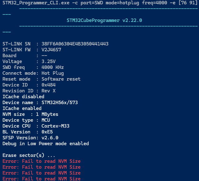

Hi Aziz,
I switched to v2.22.0 CLI hotplug mode but couldn't execute erase.
Regards,
Snaku
