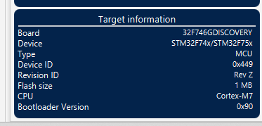

When I use STM32Programmer IDE I can erase external flash sector by sector.
When I use STM32_Programmer_CLI.exe I cannot erase the external flash.
Board info:
I get following error from STM32_Programmer_CLI.exe:
STM32_Programmer_CLI.exe -c port=swd -e all -el C:\Program Files\STMicroelectronics\STM32Cube\STM32CubeProgrammer\bin\ExternalLoader\N25Q128A_STM32L476G-DISCO.stldr

Hello @FU and welcome to the ST Community,
Sorry for my late replay.
The file "N25Q128A_STM32L476G-DISCO.stldr" you are using is an external loader file for the STM32L476G-DISCO board. Could you please try with this file instead "N25Q128A_STM32F746G-DISCO.stldr"
Maryem.
