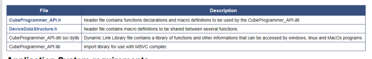

EDIT : I found the shared library in the installation folder, beside the API folder : /opt/st/STM32CubeProgrammer/lib/libCubeProgrammer_API.so
Just by changing the library search PATH in the Qt Pro file, and fix some issue in the code (missing cstddef include) I could have the example to build.
the embbeded documentation (chm) give full instructtions under "Application System Requirements". You should read it to get ready to developp with this library.
