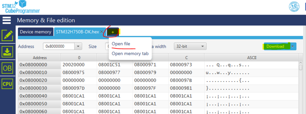

STM32CubeProgrammer has the possibility to download .hex files by adding them as follow:
