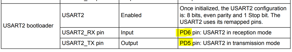

Doesn't it expect USART2 signals to be on PD5/PD6?
AN2606 https://www.st.com/resource/en/application_note/cd00167594-stm32-microcontroller-system-memory-boot-mode-stmicroelectronics.pdf

I think you're missing what @Community member​  is saying.
> Yes Tesla, but my debug/interface port is on PA2 and 3. (USART2 has several mappings).
This was doomed at the start. The USART2 bootloader isn't on PA2/PA3, it doesn't matter if those pins can be used by USART2 if the bootloader isn't listening on them.

Tesla DeLorean I think you are right about the PD5/6 pins and this is why the "standard" bootloader is not talking to CubeProgrammer. I have provoked bootloader execution by clearing the flash and pulling the BOOT0 pin high (in this case it is available but in final package it is not). And still no COM on USART2 PA2/3. I think the pre-installed bootloader only listens to PA10/11 USART1 and PD5/6 USART2.
