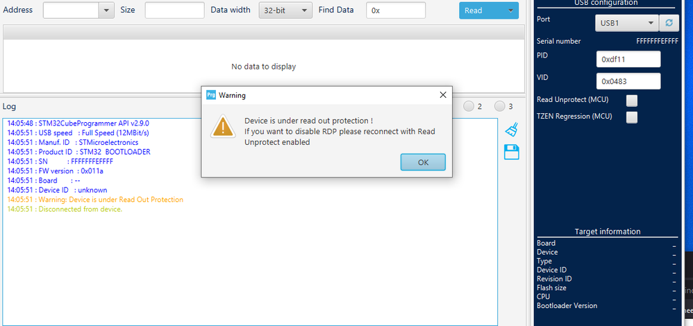

Getting "Device is under read out protection!" error when trying to program STM32F070RBT6 using USB port, Only on certain PCs
AAlla.1
When trying to connect:
0693W00000Kb1R2QAJ.pngWhen trying the same thing on a different PC (works on 3 different PCs, doesn't work on 3 other PCs). with the same IC it connects and programs with no issues.
I checked the SW version of Cube programmer, on the 3 PCs that it worked they had versions v2.2.0, v2.6.0 and v2.9.0. The PCs that did not work all had versions v2.9.0.

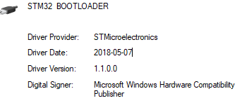

I also checked what version of Drivers was beeing used all PCs are using the same version:
0693W00000Kb1TnQAJ.pngI am not sure what else could be different between the different PCs that could be causing such an error, any help would be appreciated.

Different on PCs is USB port chipsets and drivers. Too cables connectors maybe differ.
